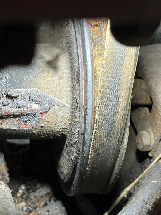

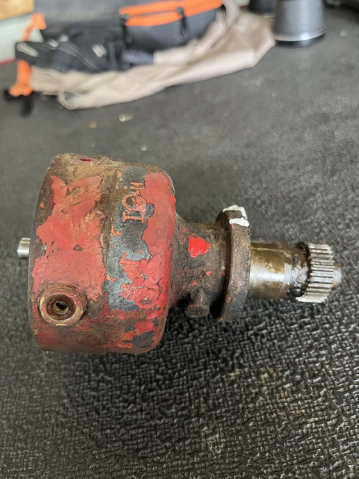

Hey all, I brought over a farmall super c and it ended up
needed a distributor. I took the distributor out of a running
farmall c because Im in a pinch. I know there is a mark on
the back of the flywheel but I dont have a dust cover on the
tractor. There is however, a pointer on the block for the
camshaft pulley. My question is
1: what does the timing mark on the camshaft pulley look
like.
2: how do I go about timing the tractor? I know I have to find
TDC of #1 cylinder by pulling the plug and watching it come
all the way to the top on the compression stroke. But what
are the steps to adding a new distributor onto the tractor?
