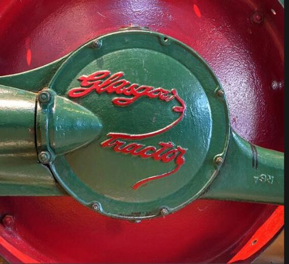

And no differential between the two front wheels, to keep it simple.
Within each front wheel hub there was a pawl and ratchet mechanism so that when the tractor was moving forward in a straight line all three wheels drove positively. When turning to right or left the outer front wheel continued to be positively driven whilst the inner one slipped on the ratchet until the steering wheel once more returned to a central position.
