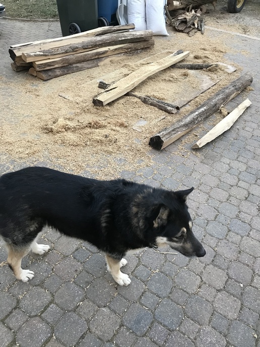

Photo of slicing locust posts from logs, with chainsaw. They look nice all squared up. We are now trying the soak in oil method. I have also charred them, which helps. I have posts on our place 30 years now, that were pulled off my dads place, at least 25 years there. He wanted all new treated lumber posts. Most of those treated posts rotted off years ago. Go with locust but use heartwood, dry them and soak the bottoms in oil. Sap wood is no good and a half round has sap wood.
