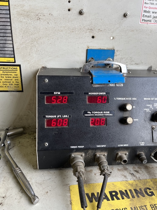

Hi coonie minnie. It is a nice straight tractor for sure. We adjusted the rpm it was running a bit slow. Wasnt getting much smoke working it hard so we opened up the fuel a bit and because it had been sitting for a long time the more we worked it on the dyno the better it got. Didnt get a picture but we got a 69 peak horse power for about 2 seconds.
