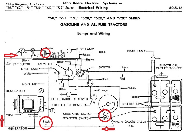

tell me the correct wiring for a jd 620 with a ballast resistor
Take a look at the diagram below.
Note the BLACK lead wire from the starter switch to the ignition resistor.

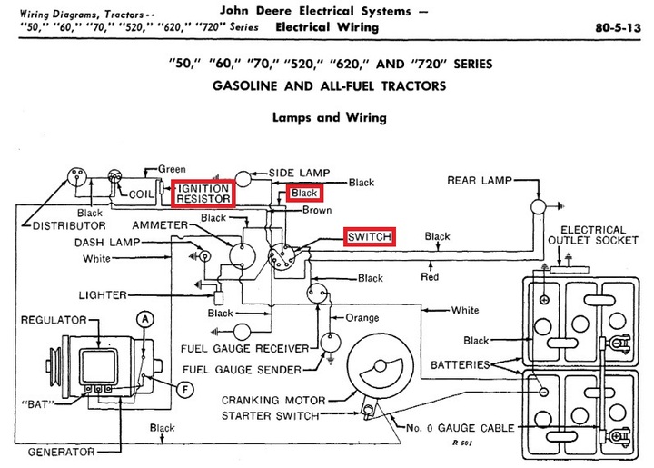

Take another look at the diagram below.
Note the BLACK lead wire from the ignition switch to the ignition resistor.

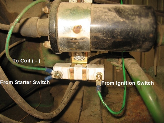

Take a look at the photo below.
Hope this helps.
