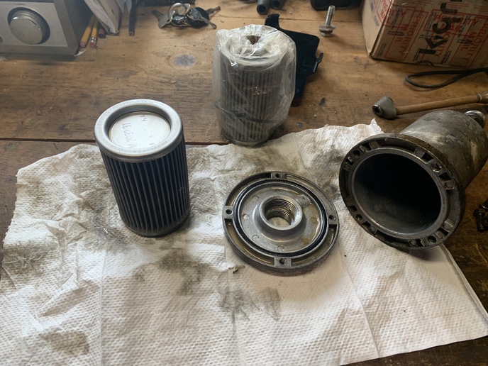

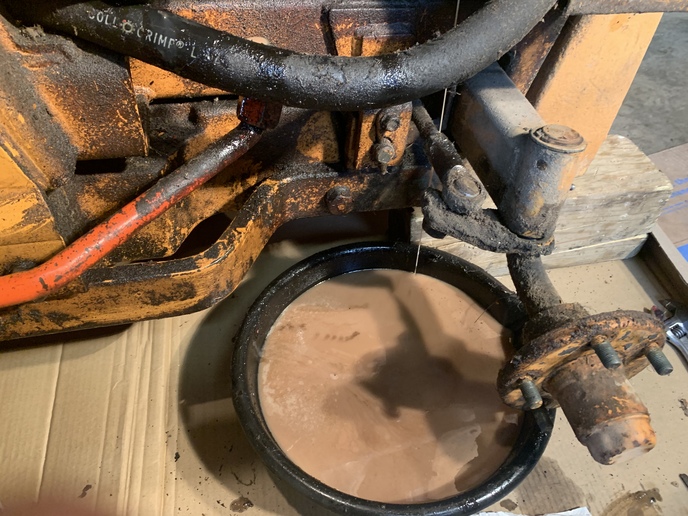

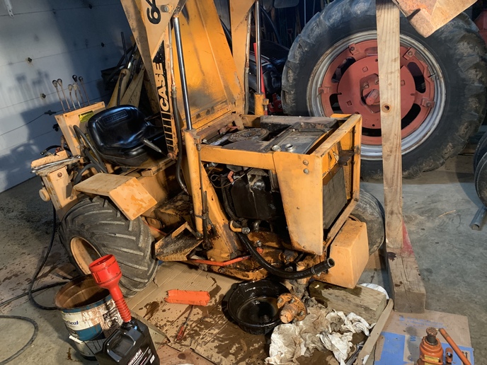

Decided against my better judgment to take a look at the hydraulics inside the shop since they were calling for rain all day, yup got oil everywhere! Here what were getting out of it.
It sure looks and feels like it has more water in it than oil. We opened about every line and plug we can get to drain it all out. Im hopeful fresh oil will help solve the slow / No travel in high gear. Got a new filter and O-ring. That was a little pricey! But we have to have it.
I think were got about all the old oil/water out of it that were gonna get. I feel like weve disassembled this poor little tractor about 3 time now, but were getting closer to trying it out!
Im thinking well quit for the day and start putting fresh oil in tomorrow. Any tips for getting air out of the system when we start adding oil? As always thanks for your knowledge and help!
