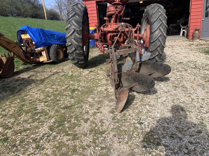

Last fall I was complaining about my poor plow job. You guys gave me some pointers that I applied today.

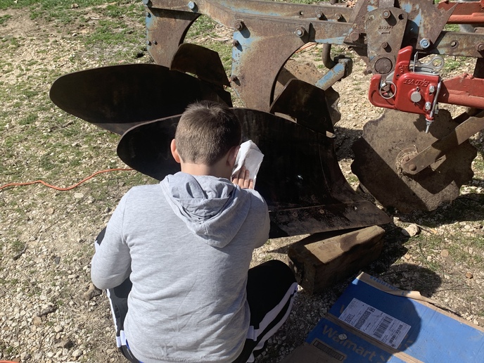

We shined up the bottoms the best we could with a wire wheel and sanding discs. Then I pulled the tractor up on a block and set the plow.

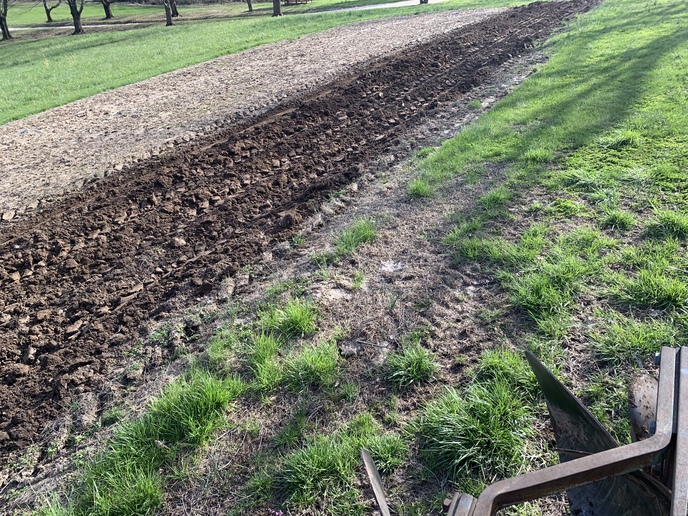

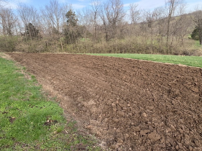

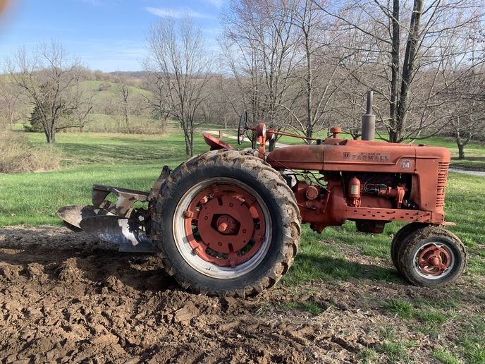

I ran in 3rd gear open throttle what a difference! Now the dirt rolls off the plow like it should. I still need to mess with it a little bit I dont think I have the them cutting even yet but its plenty good for our garden! The auction M ran great. The back corner of the garden was a little wet, that made the old M bark a little bit!
