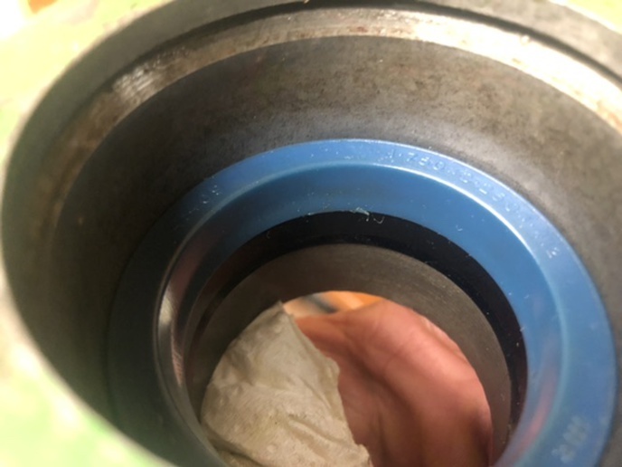

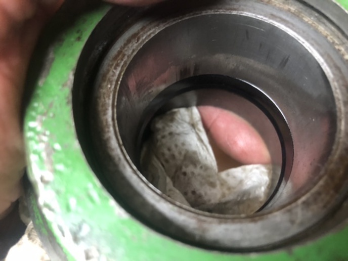

The factory only has one single lip seal to keep any oil that might get by the cups on the piston . I modified the spacer so the gland sill accept two of the single lip spacers sure helps keep oil in the cylinder barrel and off the ground .
