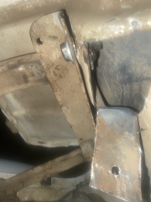

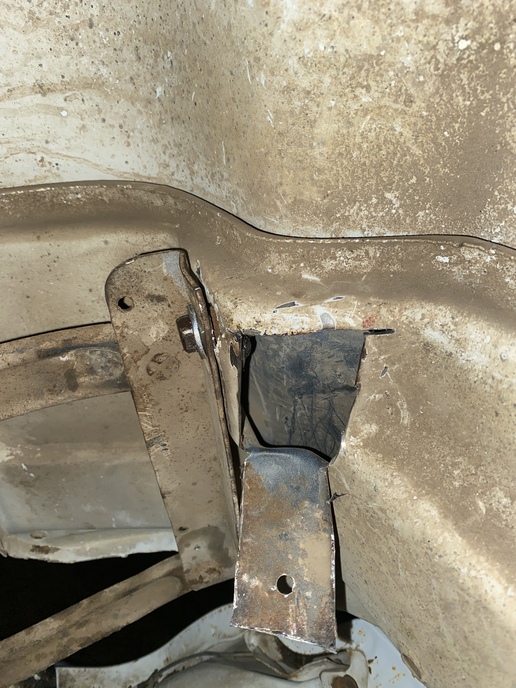

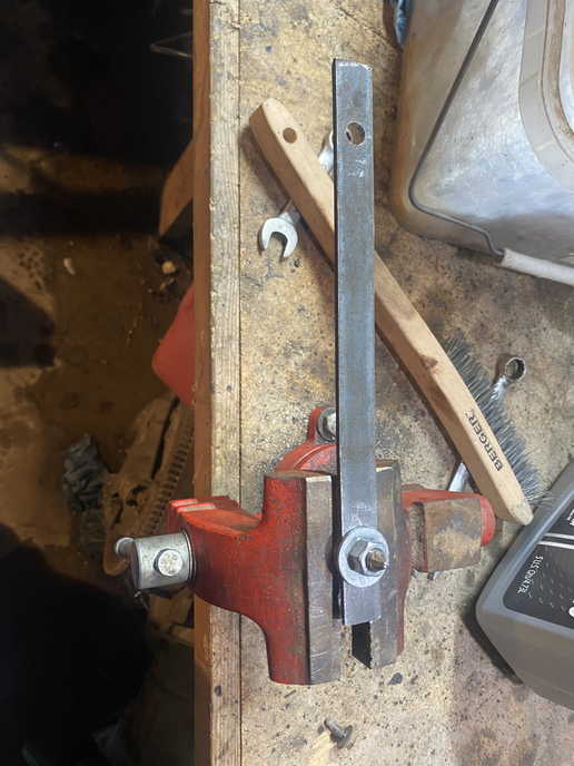

The metal on my hood ripped out so I cut an access hole then made a plate to go inside and strengthen up the steel a little bit .
