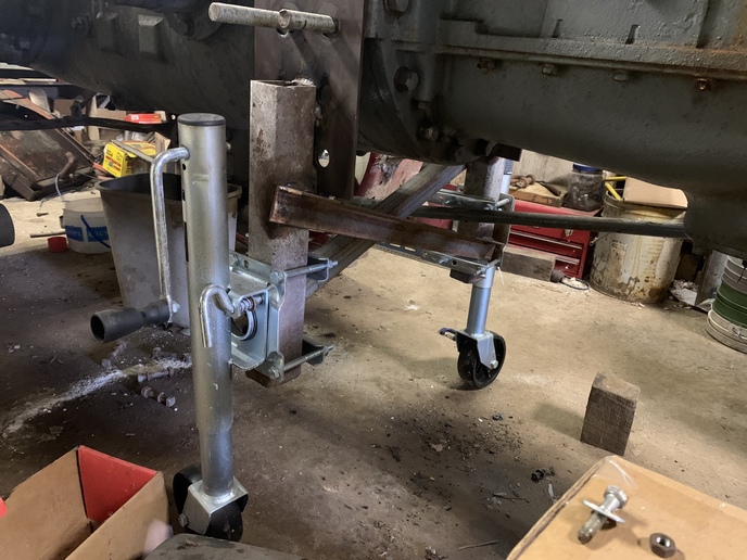

This is how we rigged our KT Twin City to split it. We used the cultivator bolt holes to mount the trailer jacks. We were able to adjust the elevation and roll the back half away. We supported the engine with a floor jack and stabilized with angle irons in the cultivator bolt holes. We had wedges in the front pivot. And yes I dont trust my floor jack to work under
