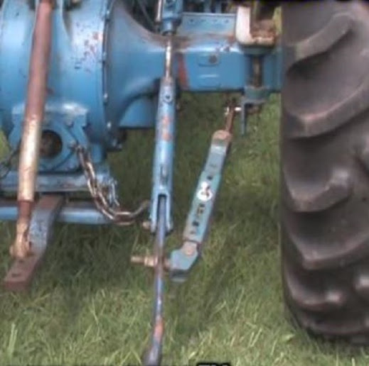

So you want to end up with this more or less.
Something about your bracket that goes under the fender isnt right, could the bracket be turned around, or needs washers to shim it lower, or something to make it line up with the three point pin across from it?
