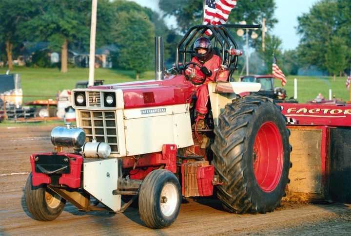

My 1466 IH puller has a DT 466 thats been taken up to 570 cubes..Like mentioned its real easy to roll one over using a small pry bar on the ring gear teeth thru the timing
cover hole...I do this all the time when running the valves or timing the Bosch P-7000 injection pump...Its been decompressed and takes no effort at all.
