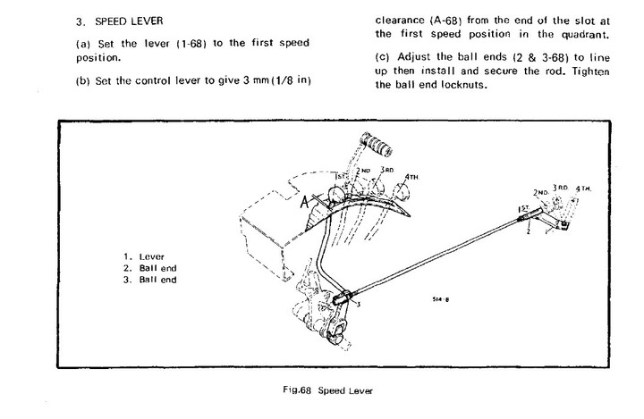

Your tractor is definitely an IH 2400 which is the Industrial version of the AG 454/464.
Re Gear shift levers, the left lever is Range Transmission lever should be REV to rear/High Range in slot half way down/ Low Range all the way down.
The other Lever with the Z pattern goes to the Speed Transmission and is gears 1 thru 4.
As other posters have said remove the cover on top of transmission in the step through and check the shift mechanism.
See attached photo of Speed Transmission connections, from the IH Service Manual Section Group 7 Page 34.
Also if the tractor has been sitting outside for a length of time, the shift lever can rust to the pivot shaft.
DO NOT FORCE or you could break a shift fork or sometime in the transmission.
