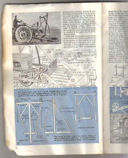

From my Popular Science book issue 1947.
Lots of interesting stuff to make from junk.
