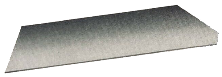

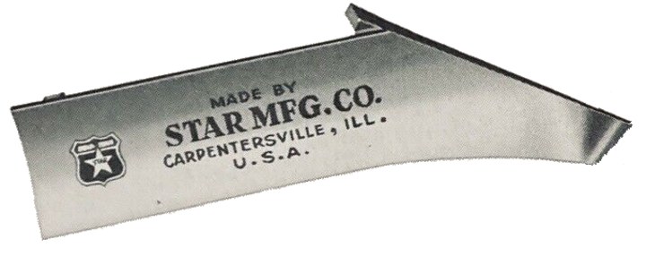

I will add to this PSA with these 3 pictures. The top Plow share picture is the newer style Throw away share that newer plows use. The one in the picture is what is colloquially known as a stub or Rock share because it has a blunt nose/point.
The bottom plow share is the older blacksmith style share that has a long point/nose which can be re-pointed by a blacksmith (if you can find one). These typically have better suction in the soil and a lighter draft (pull).
