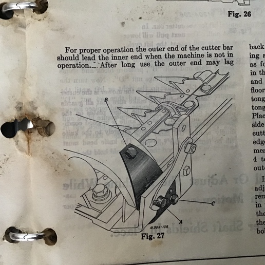

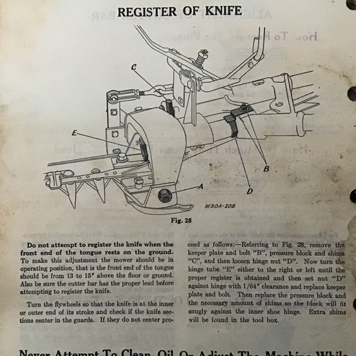

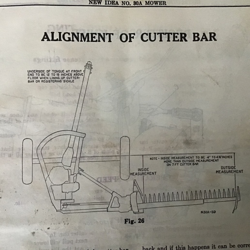

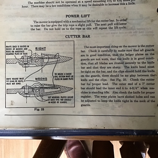

I cant see the profile of the section to the ledger plate ?
I copied this from my new idea 30 A to hopefully help you out ! Critical to have the cutter and center to the center of rock guard , if I explained it right t( the registration center)
