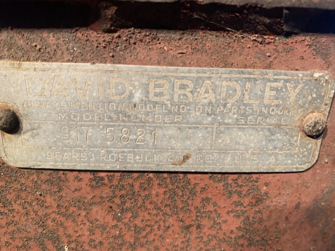

Let me say first off I believe the problem is 70 percent my own
ignorance and 30 percent worn or out of adjustment machine. This is
a 1950s? David Bradly sickle mower. Looks like model number 917
5821.

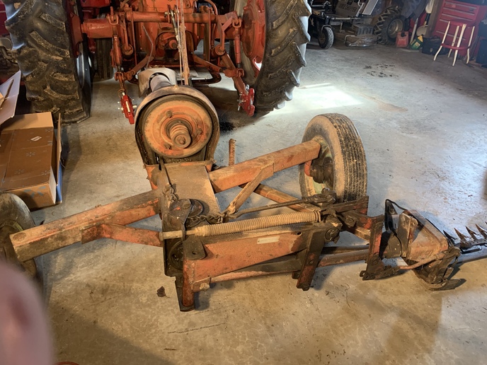

Id love to get this back in working condition but if nothing else I have
to learn how to properly maintain a sickle mower. Heres the issue. I
was using it at the end of summer to mow our pasture. It kept
plugging up. I kept clearing it and trying again. I thought I had it ready

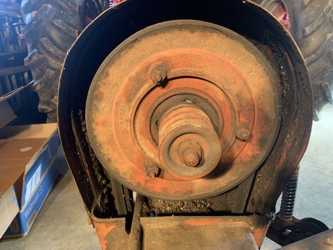

to go. Obviously not! I quit when the clutch was just free spinning. I
was pulling it with a Farmall M in 1st gear open throttle.
Now that I have it in the shop I can turn the PTO by hand and
everything appears to be working. Could I have just gotten the belt
hot and it slipped? The clutch appears to use 4 keys that it engages
on but without disassembly they appear to be intact. Also it appears

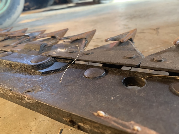

the bar is out of adjustment.
There should not be a gap under the bar right? The hold downs are
not in contact with the bar and now I see I have one that is broke off.
How do I adjust them? I havent had much luck finding a book for
this and Im hoping other manufacturers use a similar design. As
always any help or advice you can give me is greatly appreciated.
