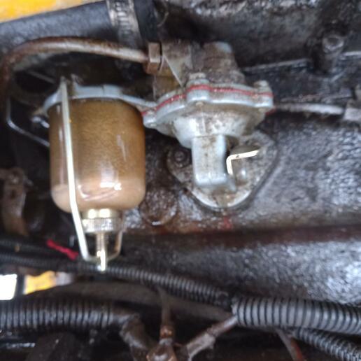

Thanks for the welcome, I'm very grateful for the time you and the other YT members put in to help me. The tractor ran in November or early December, the former owners rode it to a remote spot on the property, so about a month and a half ago. They said it was working...... But I wasn't there to see how they stopped it. When I first came out to look at the house before buying it, I took a few pictures and on one I can now see the rod was already hanging on the side then. Unfortunately now that the rod is so bend it is hard to figure out where it went, maybe they drove over it themselves. For most people getting a tractor to run is the problem, but for me it is foremost to get it to stop :-). For now, if it doesn't run, I'll join the queue again.
But yesterday I did see whitish stuff in the sediment glass bowl next to the fuel pump so there is water in there and I'll clean that out before starting (see pic). I can take pictures of both engine sides but they are smothered in inches of black greasy muck, and the whole thing is also very obscured by the front loader side frame. I did try to clean off parts like the bowl to see if there were any numbers to go by. I looked at the links you send me of the parts diagrams and those exploded pictures have been very helpful. It showed an exact same sediment bowl with fuel engine for diesels, together with the specific shape of the fuel tank and Dieseltech's reply I think we can be sure it is a diesel. Tomorrow I'll go out and look to find the injection pump and see if I can hook it up again. I'll update the results.
