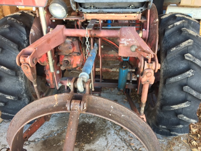

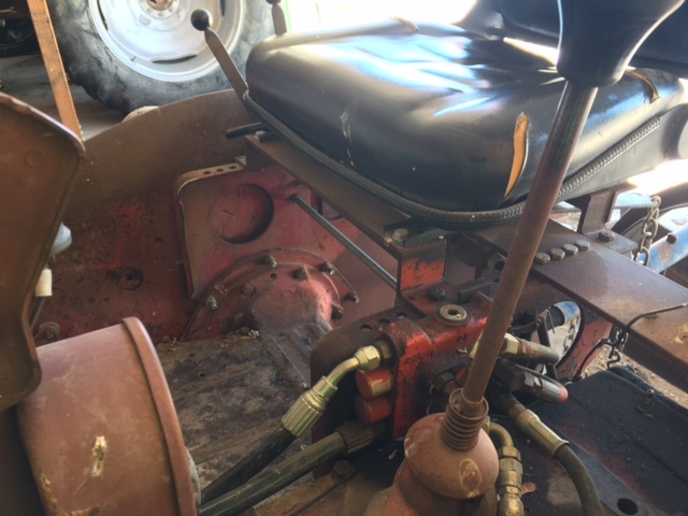

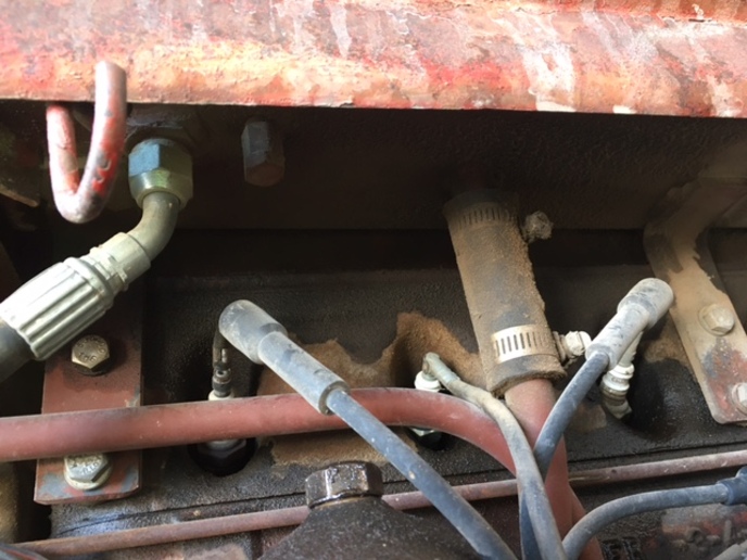

My front blade was kind of homemade from the get go. I just had a five foot cutting edge and bent the moldboard in my press. There are two small straps that go from the top back of the moldboard and bolt to tabs welded to the push frame. Those bolts are soft 1/4 inch ones so that if I hit something they shear off and the frame does not get bent. But you can see in the picture that I have tested it many times. Nice looking Super C by the way. I have a C to fix up as well. Some of the three point hitch is off of a Case. One picture is of the bottom of the hyd tank I made and fastened to the head. The valve is mounted to the left side of the seat frame and the control levers are on the right side of seat. Today it has a six foot grader blade on the back. I just has a receiver hitch for a drawbar.
