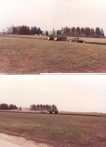

Had a Deere 3200 6-18's plow--pulled it good--I wished I would have kept the 7020--Mine was a early one but someone put the 4630 engine in it.
