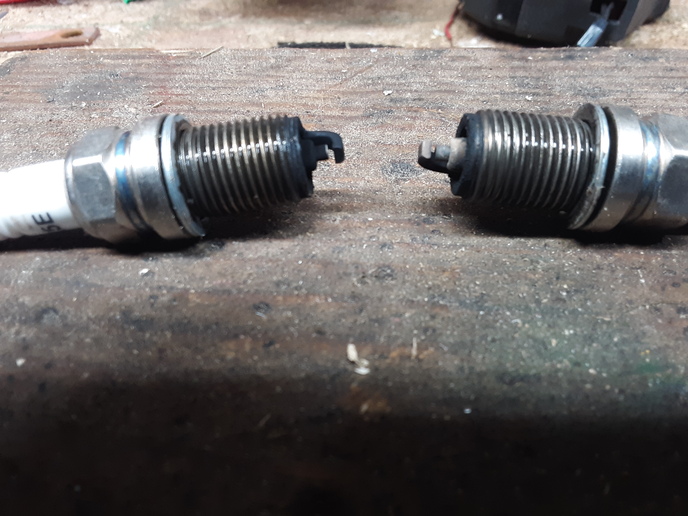

After sitting for a few months, the engine was hitting on one cylinder for a few seconds and blowing black smoke until it fired on both cylinders.
I installed a new plug after draining summer blend gas, added seafoam and atf fluid in winter blend. 1 oz per gallon.

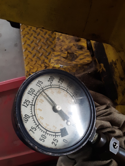

Wrong. Compress was same both cylinders

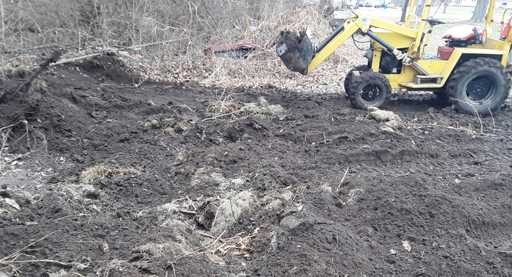

Gave it a shot workout moving compost pile.
All is good, considering it has 2000 hrs on engine. Doesn't use oil.
