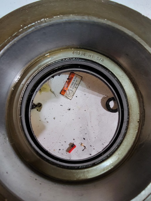

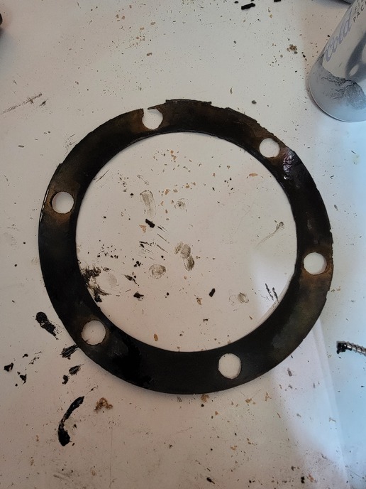

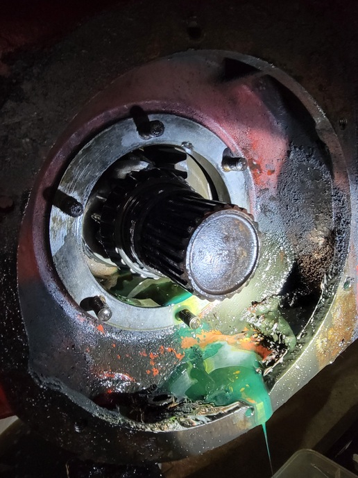

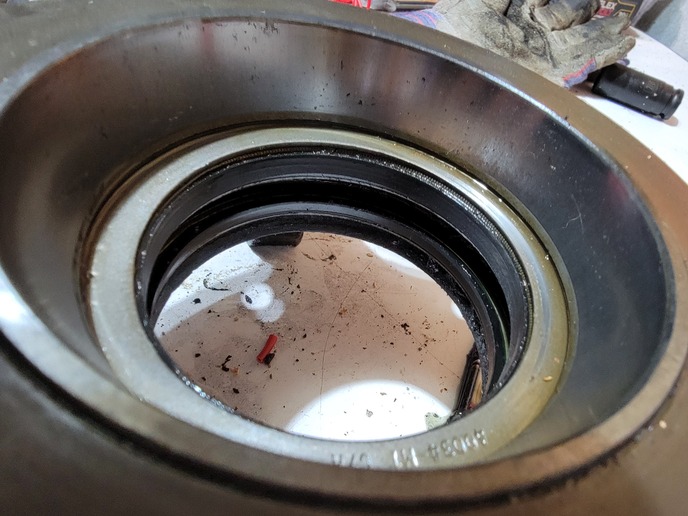

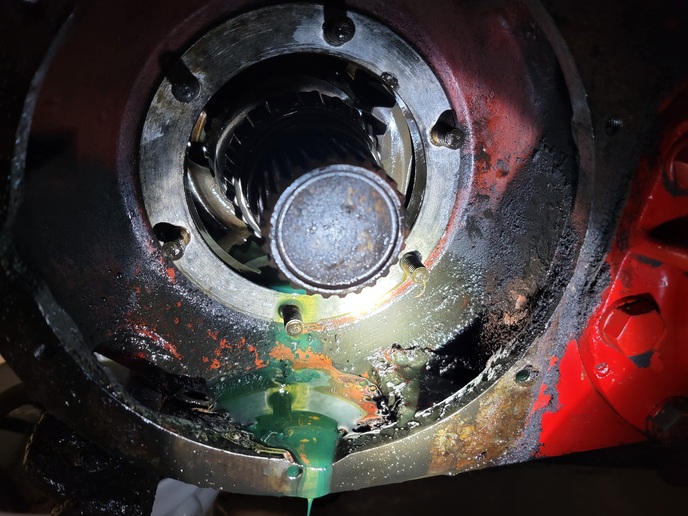

In the process of draining and refilling transmission I discovered a significant leak in the double disc brake assembly on the left side of tractor (non-live PTO). No wonder the tractor was about 7 gallons low on fluid - my question is related to the oil seal around the shaft. Is this removable? See pictures.. The parts diagram in the shop manual does not show this section anywhere.
I am going to make a gasket for the one in the pictures but I can't seem to figure out if there is a shaft seal and I don't want to damage it if I can't get a new one.
