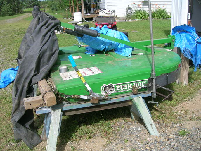

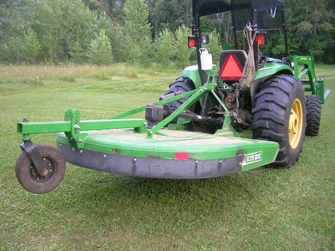

I put a complete new skirt on our Bush hog, at least that's what I call the 1/8 by 6 piece that was around the back. but I used 1/4 x 6, and
it's holding up much better. I bolted the center of the new steel to the back of the cutter, and then pulled it around with 2 come-a-longs,
c-clamped it and welded and bolted it. It looked like new after I painted it. Where did you put the pipe, around the bottom of what I call
the skirt? That's a good idea.
