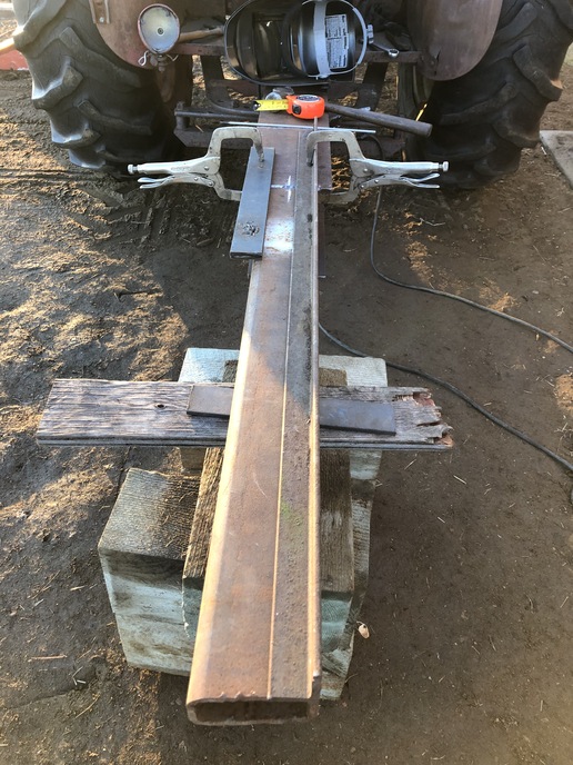

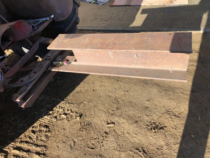

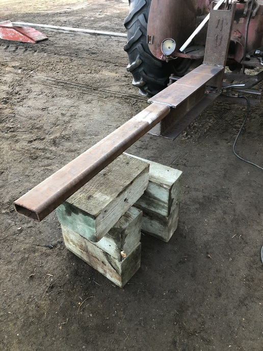

yes a wood splitter. just going to make it simple and strong. kinda wanted a longer I beam but thats all i had so just extended it. and decided to go with 3 cyl with 11 in. stroke. was gonna go with the 2 in. cyl with 2 in stroke but thought i will end up changing to the larger cyl anyhow. got some big old knotty spruce blocks to split. gonna run it off the charlyn pump on the ta w6. that way just stand behind the tractor and operate hyd's. , that way dont need an engine or control valve . just tractor will burn more fuel than a small engine but its not like going to use it often.
