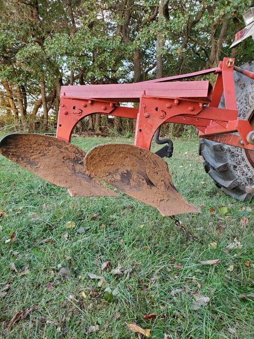

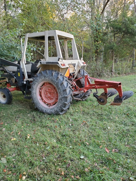

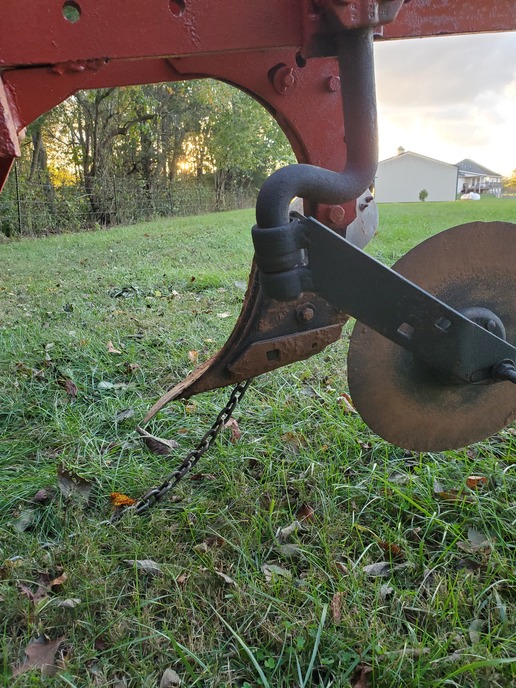

Well it's fixed. I tried being gentle with a 6 ton jack and moved it about an inch before my jack maxed out. Took SVCummins advice and found a big Mulberry tree and a long heavy chain. First attempt just putting pressure on it spun the tires. Put about 6 of slack in the chain and when it hit the end of the slack it snapped back in place so fast I missed seeing it. . Thank you all so much for all the advice. Would like to pull the bolt and clean it up but saving that battle for another day.
