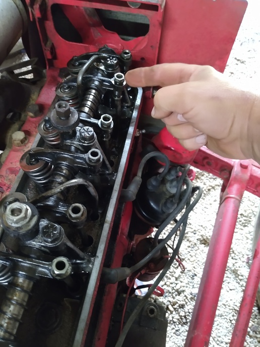

Compression check last week showed ,
front to back 5,120,115,120. So,
hood,gas tank and valve cover are off.
Doesn't appear to have a stuck valve.
Second valve back, on #1 cylinder, the
lifter is easy to spin with my fingers
until the spring starts to compress.
Very,very little up and down play. What
next? When I pulled all the plugs to do
compression check,all 4 plugs were
lightly sooty black. Tractor runs fine
some times, it's an occasional miss.
