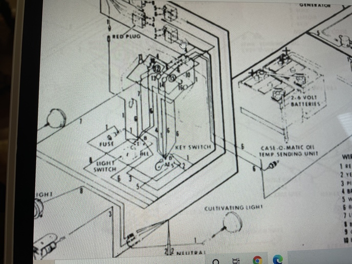

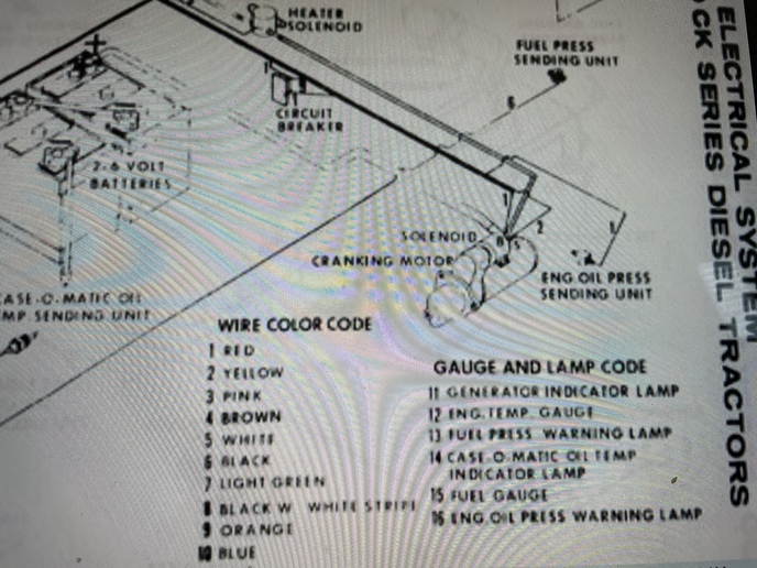

Does this offer you any help, this is the best I can come up with.
