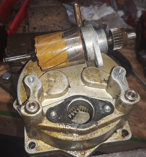

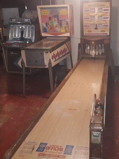

The lift motor on the 1956 Bally bowling machine is making a racket. To start it I have to spin it by hand.
Took the motor apart.
The bearings doesn't seem to have a lot of play. As you can see the rotor has been rubbing.
The stationary part of the motor only shows rubbing on one side in a small area at the end. Not all the way around.
Have you ever filled a little off either the rotor or the stator to get motor to work?
