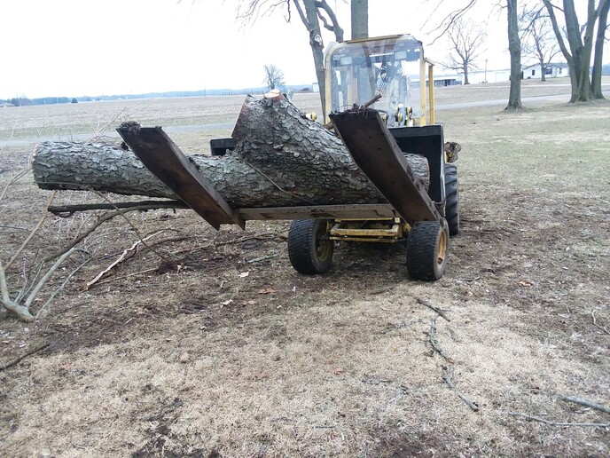

I made my bucket forks using recycled 7
inch channel for terramite. Very handy.
Removing the bucket is very difficult.

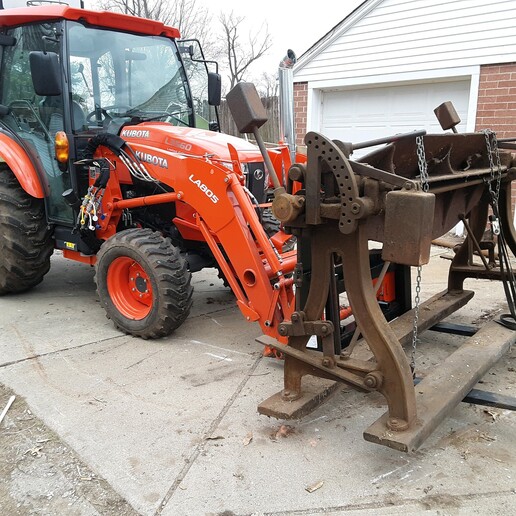

On the other hand when you need to lift
something extremely heavy
You need to get the object as close to
the front wheels as possible.
The Titian forks are worth every penny.
