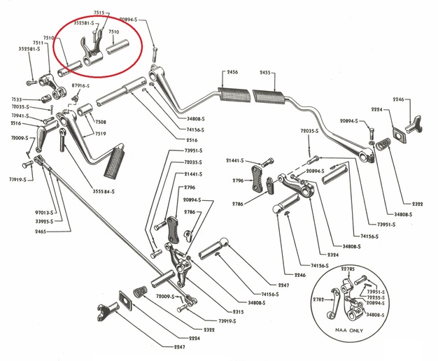

He might have sheared the pin that holds the throw-out bearing actuating fork to the shaft.
Does the pedal go up and down without any resistance?
