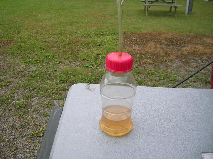

I use a primer bottle, with a little tube in it, it allows me to meter fuel in. I have run engines with it that didn't have the carburetor in
place, works great for troubleshooting. I always use 40-1 mixed gas, a little oil makes them start better too.
