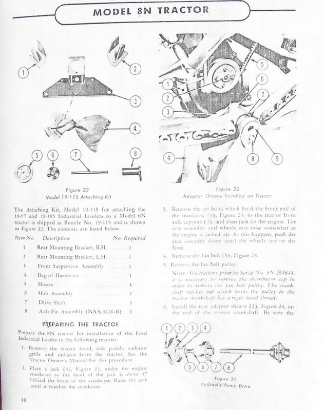

That looks like a 703 except the horizontal arms that go to the back of the tractor and pin to the axle brackets aren't there. Also do you get the pump, pump mounting hardware, front drive shaft etc? I'd say keep looking, too much work to adapt.
