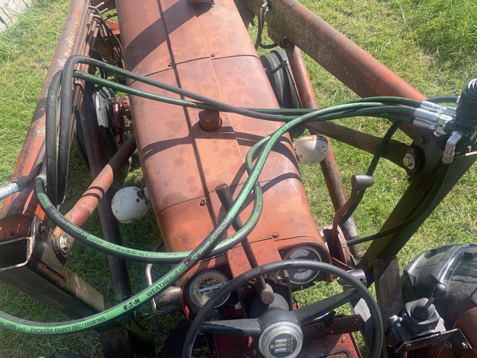

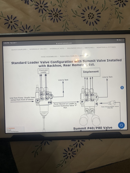

The right pair runs to the lift function of the loader while the left pair runs to the tilt function of the loader, I know that these are hooked up correctly based on the diagram sent from the manufacturer, the cylinders are double acting and the joystick is designed for that function
