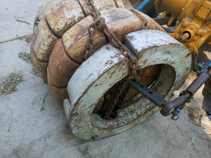

There are a few kinds of weights that will fit.
These stackable weights fit on 3000/4000 centers = 80 lbs ea.
There are two styles here. Pie weights = 600 lbs ea side and a one piece weight that bolts to the 6 wheel/center bolts = 300 lbs ea side

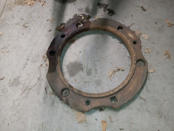

There is also a 3 piece weight that bolts to the 6 bolts that weigh 225 lbs ea side.
I have had these on half a dozen different tractors from a 2N to my 3000.

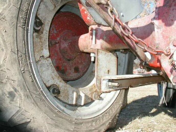

With the 3 piece style make darned sure you get the special wedges with them. Otherwise they are unmountable.
Likewise with the pie weights you Must get the special stud nuts and mounting plates for them.
