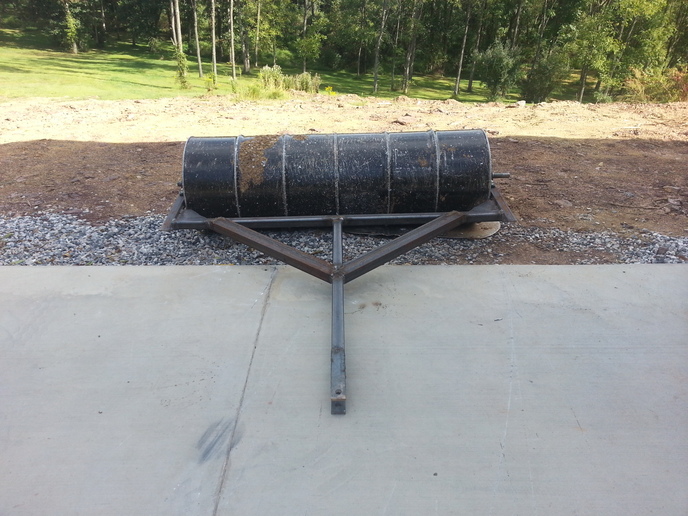

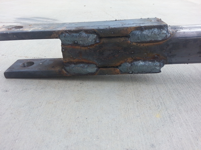

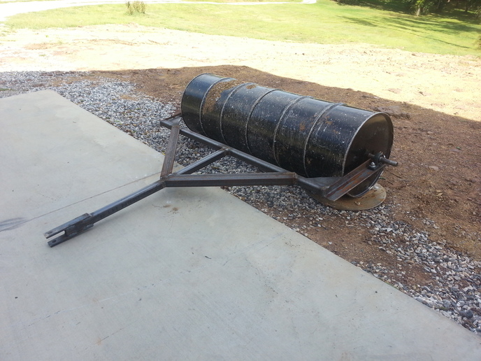

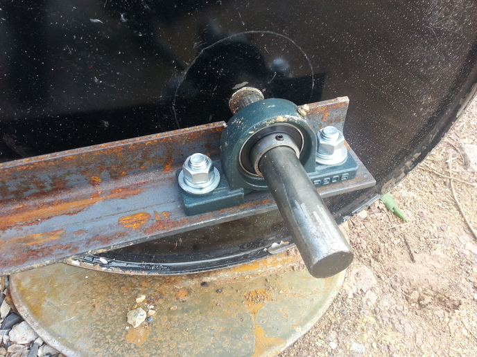

Here are a few pictures of my home made lawn roller. It is two 55 gallon drums welded together end to end and filled with concrete with a steel bar through the middle for an axle. I think the steel bar is 1.5 in diameter. Then I built a tongue around it. You're probably pretty close with your ton estimate. Probably a bit more than a ton once the weight of the steel in the tongue is factored in. It is all I want to pull with my Case VAC. My International cub loboy 154 will not pull it, it just spins.
