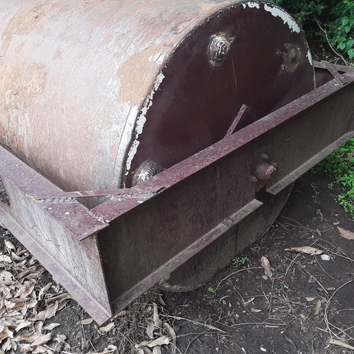

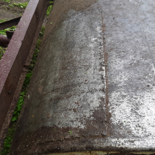

Here are some pictures of the 5000# roller I made 15 year ago. It was my first retirement welding project.
I pull it behind my 72 inch woods mower.
I decided to roll lawn after I got 2 plus inches of rain. In true redneck engineering, everything was FREE, except for welding rods and 7 bags of Portland cement
500 gallons of water would have been just fine, except the tank wasn't made of thick enough metal. So I cut out 4 bung holes and made 2 places to get inside. Weld rebar, add forms and it took 7 different concrete pours to line tank,
Make a place to add about 250 gallons of water. I added water once and Jubilee was clawing grass for traction . Only use this roller on level ground. Don't stop real fast. At 5 mph, you know it's back there. I made the roller to flatten mole runs, which it does. I was hoping to crush moles, which it doesn't. Next day moles are laughing at me, I'm back.
One time I had white rock stuck to roller. Went over sidewalk and made powered lime.
So far my redneck roller has worked for 15 years. I transported it to my WTH property. It took me half day to secure roller and transport it. I transported it back to property where I built new pole barn and said I'll never move it again. If I think it's scary to load and move, you know it has to be scary. Never again.
