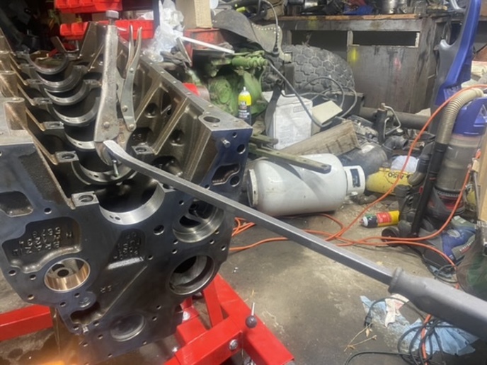

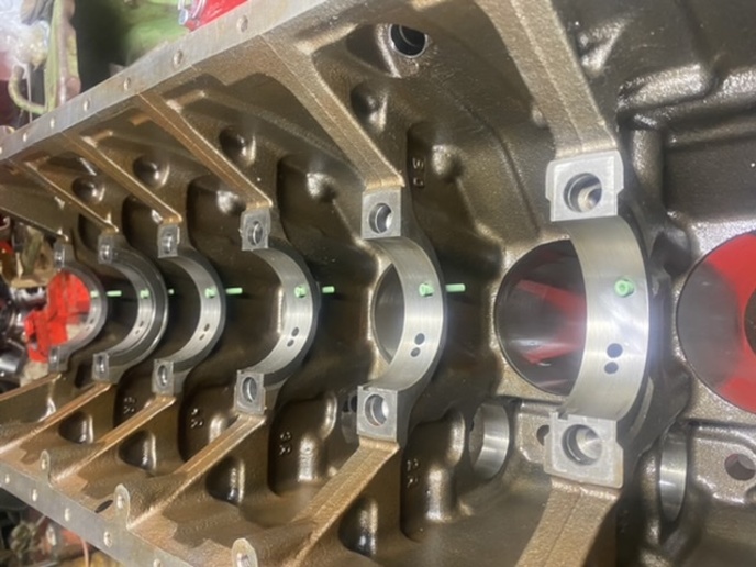

According to my calculations I have 2 thousandths oil clearance spec Is 4 . Im going to grab some plasti gauge and see what it comes up with just to be safe

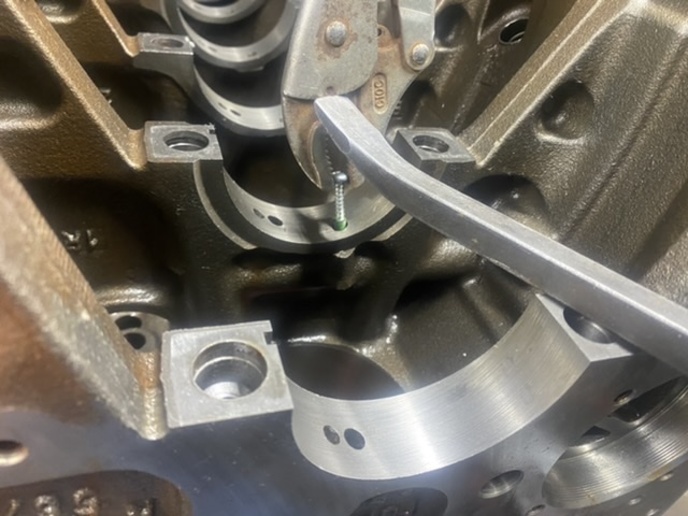

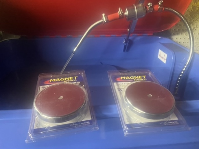

The one pistol cooling nozzle bore is made different had to screw a wood sheet metal screw in and a pair of vice grips and pry bar popped it right out . I think harbor freight must of updated their pumps Ive had mag 1 solvent in it for about 3 months now and the pump still works fine. Put a couple big magnets on the bottom of the washer tank to help ketch some of the metal particles that could be floating around
