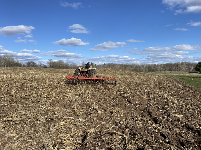

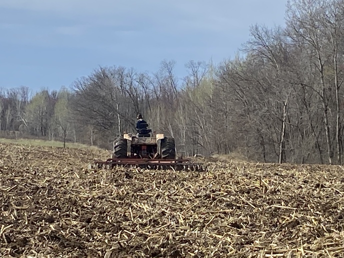

Finally got some planting done this year. Been hovering right around being ready for most of a month, but always just enough rain or snow to hold it off. Got enough snow early Saturday to turn the ground white and had flurries again last evening. But between I got my oats in. Used my heavy disc on last years corn stalks behind the 1030 to start. That is Randell, my grandson driving again this year.
That disc is heavy, and with 24 blades and 16' wide the 1030 knows it's back there. Especially on this ground that I just rented with some steep hills. Then went over it with the light 14' disc. The 1030 hardly knows that's back there.

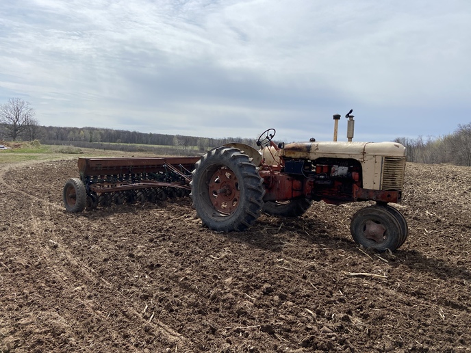

Planted with the 400 this year. It really runs nice now since the rebuild.

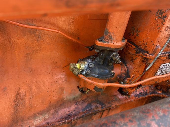

I had to put a new needle and seat in the carb on my dc and when I tried to hook up the gas line after I had a leak, when I tried to take the elbow out the casting just broke off the carb. I tried an old carb I found at a salvage yard, but it was broken inside. So I decided to just build it up with braze and drill and tap it. Seems to be working good.
