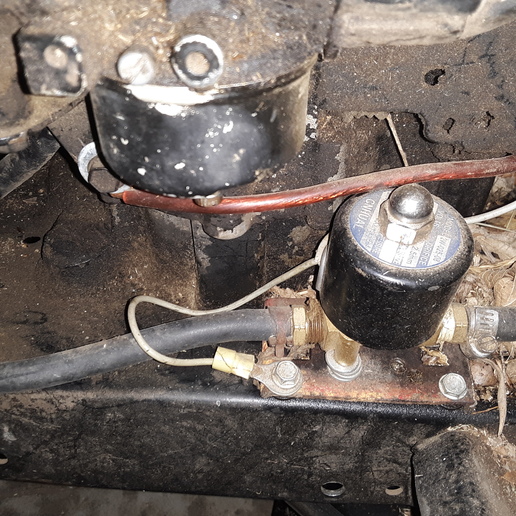

I've seen B&S carbs leak and fill the crankcase with gas.
I've installed 12v inline solenoids to prevent leaky carbs on mowers and Farmall, Jubilee.
Standard equipment on T5C terramite .
Possible a solenoid could help you.
George
