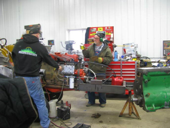

That is too bad--When we do a first start on a new build it is a 2 person adventure--1 to start it and the other to shut it down if needed. Do not depend on the fuel shutoff in the pump--if it has a external fuel shut of it will work but we go for the air shutoff.---Tee
I have a can of either in one hand and a clipboard for air shutoff in the other--this was 1st start on our 500 3 years ago.
