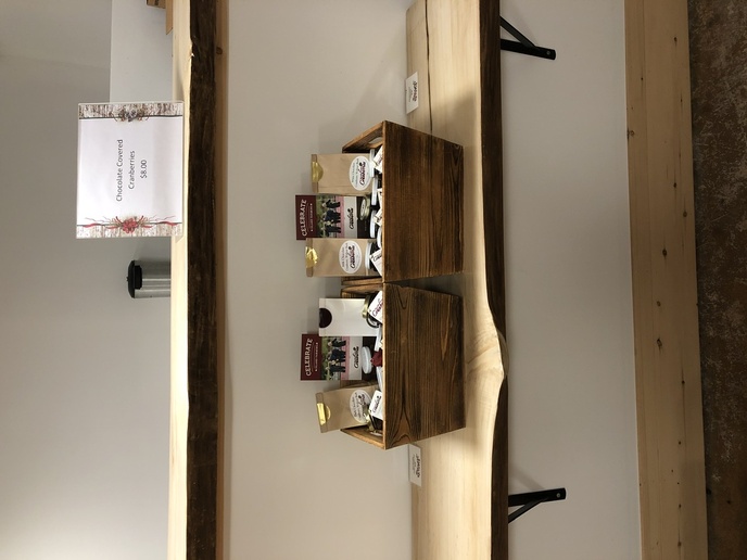

Thanks very much for the information Pete. Slow drying will be my plan, no fan. Yes I plan on keeping the planks mirrored that�s why I sorted them. I will number the ends too when stickerd so I can keep track of them easier... all peaks up.
The slab counter that I did was 2-1/2� and was actually two pieces butted up to each other, I think an 8� and 5�. It was a bit of a rush job to get something in place, I wasn�t surprised there was shrinkage. Both pieces also cupped up a bit. It�s not really a big deal. It looks rustic.
It�s been at least 3 years now and they have stoped moving do one of these days I�ll unscrew them and run them through the planner again.
You can�t really tell the cupping in the picture. Actually it not even really pretty or interesting... it was young, about 28 years and very white. Up close there is some nice grain but nothing like this tree.
