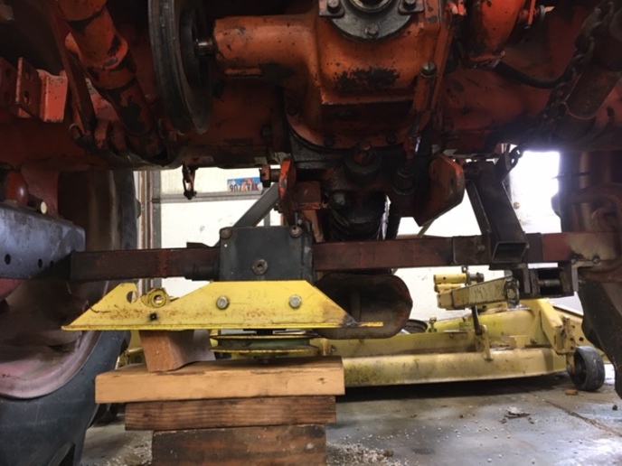

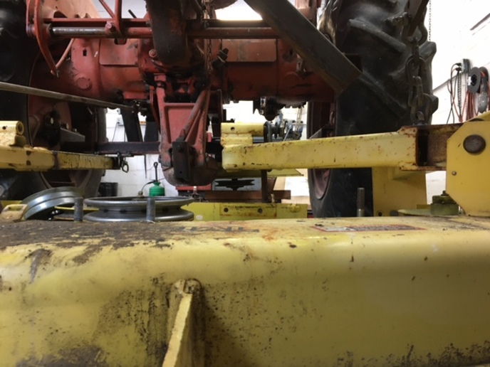

I have mounted a John Deere three blade commercial mowing deck under the belly of a CA Allis. I found a tapered hub and some pulleys at the junkyard off of a M2 Gleaner grain head. The hub fits nice on the belt pulley shaft of the CA. The mower had a right angle one to one gearbox on it. I first thought about making a driveshaft with a pulley on the end that could belt up to a pulley on the 540 pto. Then I saw that the belt pulley turns 1280 rpm. I don't know what this mower was on, but I bet it was driven at crankshaft speed. In the picture from the back I have the gear box setting on blocks so that it would line up with the drive and driven pulleys. This set up would use two shorter belts. If I just used some idler pulleys instead of the gearbox I would need one very long belt. Saw on Ebay a hexagonal belt 150" long for $60. Would that kind of belt work good for this? Would the gearbox rob too much power? Should I go back to the drive shaft setup? Can't sleep!!!
