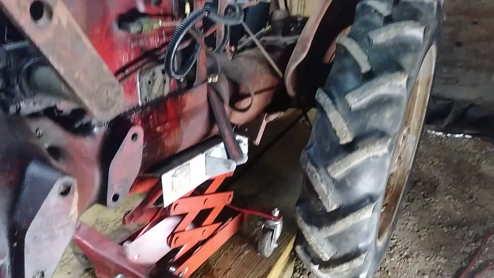

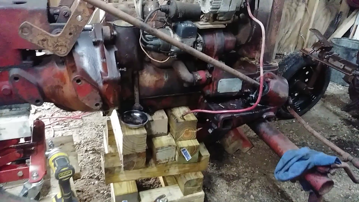

Split a '49 cub today. New throw out bearing and clutch adjustment. Took 3 hours. Then we pulled both final drives and replaced seals. Cleaned the brakes by soaking them with brake cleaner and sticking them in the fire in wood stove. Grease bubbled right out and burnt off. Tried to fire up the tractor for a test drive and the switch melted! Darn. Couple new wires and new switch. It runs and drives.....and stops.
Bunch of 4x4 blocks. A couple 2x12s and a harbor freight transmission jack.....easy job
