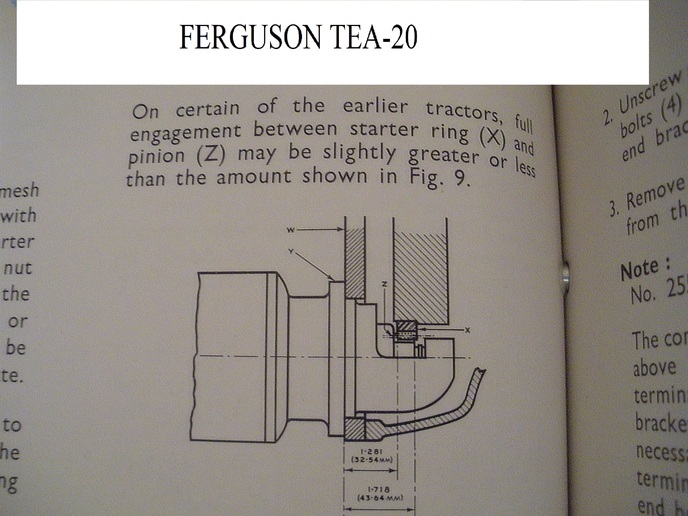

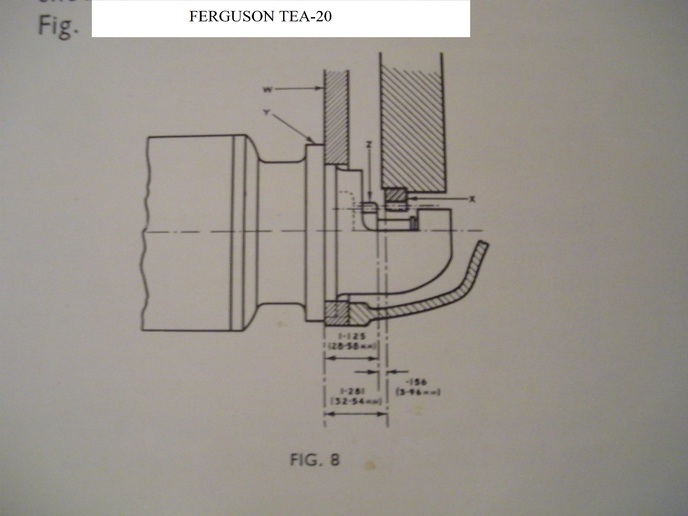

However......I have had to add shims on a TEA-20 Ferguson, as starter drive was over engaging causing the drive to destroy itself as well as ring gear...6 VOLT system..
And yes the spigot of the starter was a size for size fit into the bellhousing bore..
