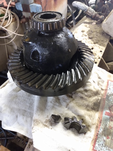

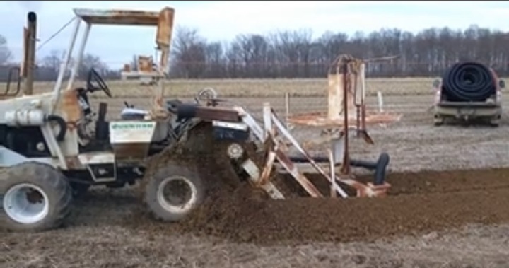

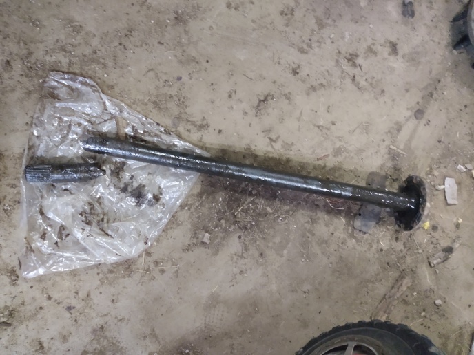

I was moving my trencher, attempting to cross a trench I just filled. As the rear axle went across and dropped in, there was a big snap and it quit moving. Here's what happened near as I can figure. One spider gear broke, a broken piece locked up the differential. Then all the power went on to the left axle snapping it too. Can't believe it since it's a Dana 70.
