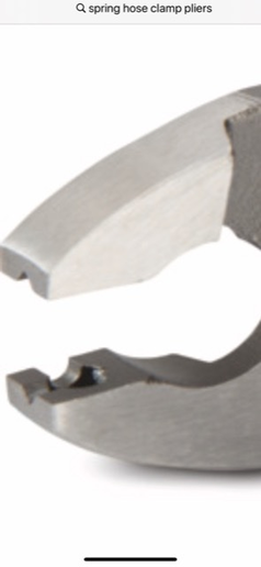

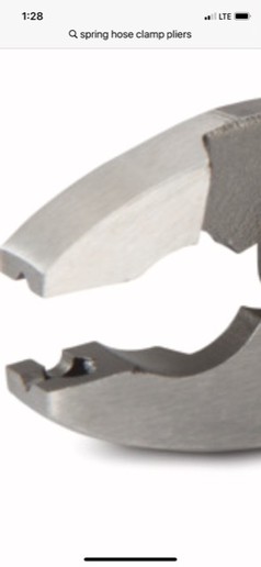

I made pliers like these by cutting a groove in each jaw with a cut off wheel on my grinder . Without them it is a lot tougher job
