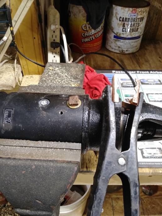

Took the starter off. Was sparking terrible and ground to a horrible death. Tap with hammer handle and it made a couple more turns. Any way put it in a vice. Spins over fast,quiet and easy...... Little copper square was loose...... At first it wouldn't work with the switch. Took switch off touched terminal and it works fine. Bad wires or connection on tractor?
