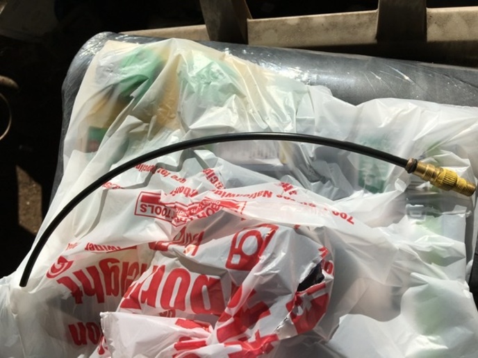

I went to town this morning and got a piece of 3//16� tube at Napa. Came home and drilled through an old valve stem and stuck the tube inside it.
Took out the valve stem and screwed the one with the tube in and put some air in the tire and it was slow, but after adding more air a couple more times I got all but about a gallon out of the tire. Started breaking the tire down. Got one side done and started on the back side. They are 8 ply and fighting me all the way. Had to move the bead breaker 4 times to get the outside broke down. I expect getting it off of the rim will be a challenge!!!
