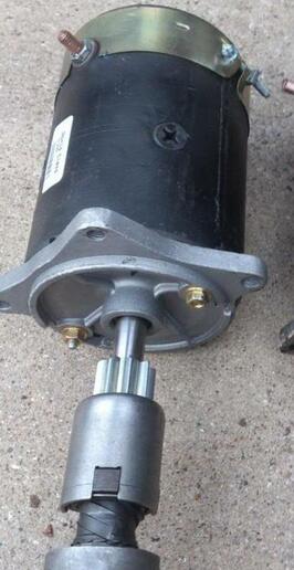

Well it looks better, but is not actually better. Even booster cables will make a starter spin so fast so quickly that it will scare you. it will not
be mild and gentle picking up of speed. it is dramatic and violent. If the battery is charged, the starter is nin need of rebuilding or replacement.
There are still good shops in some towns, Our town in St. Cloud MN has Reds Auto Electric. A real repair rebuilding knowledgeable staff. The drive
should look like this one, and the pinion gear must be pulled back out of engagement with the ring gear, and yours is not!!! Jim
