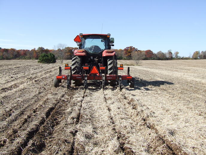

This is also no til type farming. Those are 3/4" wide shanks with no-til deep rip points that leave a tunnel down about 18" deep. Could pull a mole ball on each one but no need to. My entire farm gets this treatment but only when soil and crop residue are right. Too wet? Don't do it. After the soybean crop is off. Every other year. If I can.
